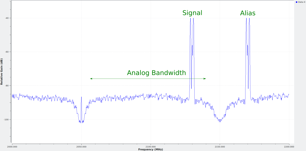

Starting with UHD release 4.1, the X310/X300 FPGA images no longer contain a halfband anti-aliasing filter directly after the ADC when using TwinRX. The filter was left out because the radio no longer decimates the sampling rate for TwinRX, instead relying on the DDC RFNoC block to adjust the sampling rate, and the DSP utilization of the filter was permanent, even when no TwinRX daughtercard was used. This means the output of the radio block (which produces a 200 Msps output signal when using TwinRX) contains aliases of the signal. The following image shows the output of the X310+TwinRX when configuring it to run at 200 Msps. The center frequency is set to 2.1 GHz, and a signal is applied at approx. 2.13 GHz.
TwinRX Signal Aliases
Due to aliasing, a mirrored alias signal will also appear at 2.17 GHz. The statically connected DDC block will remove these aliases.

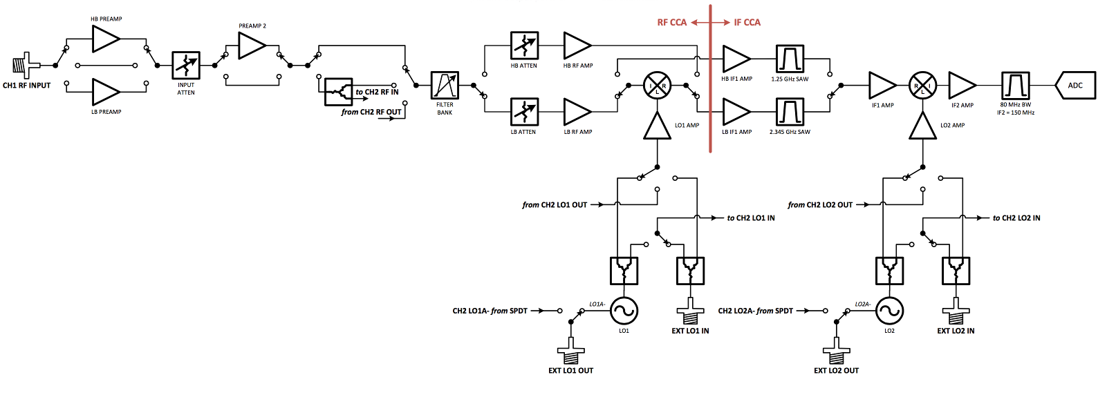

The receive filter banks uses switches to select between the available filters. These paths are also dependent on the antenna switch settings. Incorrectly setting the switches generally results in attenuated input / output power. Receive filters are band pass (series high & low pass filters).
Source code related to controlling the filter band and antenna switches resides in twinrx_experts.cpp. Specifically, refer to the twinrx::twinrx_freq_path_expert class. Generally, these methods set the switches depending on the state of the receive streams.
The following sections provide switch setting tables for antenna and filter selection for frontend's receive paths. For further details refer to the schematics.

The TwinRX has two external antenna connectors (RX1 and RX2) which can be switched internally to either receiver channel. By default RX1 is connected to the first channel and RX2 to the second.
When routing the antennas in any configuration other than the default there are some behavioral changes to be aware of. As can be seen in the block diagram above the signal path from each antenna can be switched into a resistive divider and then to either or both of the receive channels. If the divider is in use the incoming signal will be slightly attenuated when compared to the direct passthrough. If both receive channels are configured to use the same antenna the first two amplifiers and are a variable attenuator are shared. The effect of this is that the first channel's gain settings for those amplifiers will override the second channel's. If both channels are tuned to the same frequency band and at similar gain settings the effect will be minimal, but if the frequency or gain difference is large the resulting gain on the second channel could be significantly lower or higher than expected. Additionally the signal path length will increase in comparison to the direct antenna mapping so the phase of the received signal will be different depending on the antenna mapping.
