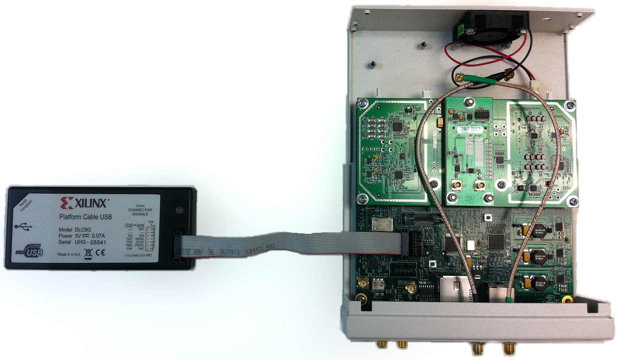

Unbricking an N-Series Device
You'll need:
  • JTAG programmer: please connect it to the JTAG connector on the motherboard as shown in the attachment
  • Xilinx 'iMPACT': launch and cancel the new project wizards. You should be left with the screen which shows a single FPGA chip in the main document (auto-detected by the programmer).
N2x0 JTAG Connection
Download the latest FPGA images, e.g. using uhd_images_downloader.
There is a sub-directory in the archive below the firmware/images called 'bit'. Use Impact to load usrp_n210_r4_fpga.bit via the programmer (the filename may be different depending on your device type and revision).
The USRP should now be able to communicate on the network (you'll see some LEDs light up and network link be established). The next step is to flash the device and program the serial number. Both these steps can be done with UHD (the JTAG step is complete).
To be sure, run uhd_find_devices and it should appear in the list - remember this IP address for the image loader utility (should be 192.168.10.2 - make sure your network settings enable to you communicate with that subnet!).
The first step is to flash the unit's safe-mode image, and then do a normal flash - both with the UHD Image Loader utility.
Make sure you have UHD installed, and the images from before, and follow the instructions in Load the Images onto the SD card (USRP2 only). You can combine the --fw-path and --fpga-path arguments into the single invocation of the image loader.
You will probably use "usrp_n210_fw.bin" for the firmware and "usrp_n210_r4_fpga.bin" for the FPGA image parameters (use the full/relative file path if your current directory is not that of the images).
uhd_image_loader --args="type=usrp2,addr=192.168.10.2,overwrite-safe" --fw-path=usrp_n210_fw.bin --fpga-path=usrp_n210_r4_fpga.bin
Use the overwrite-safe option the first time, and then repeat without it for the second time. Don't forget to power-cycle the device after it has been flashed.
