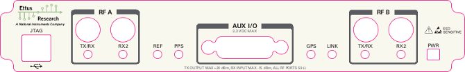

On-Board JTAG Programmer
The USRP X3x0 includes an on-board JTAG programmer, built into the motherboard. To connect to this JTAG device, simply connect your computer to the USB JTAG port on the front of the X3x0 device. You may now use the JTAG programmer in the same way you would use any other, including:
In order to use the JTAG programmer with the Xilinx tools, the Digilent drivers and plugin have to be installed first. Although recent versions of Vivado ship with the driver, it has to still be manually installed.
To install first locate your Vivado installation path on a Linux system (default is /opt/Xilinx/Vivado/<Version>):
sudo `find /opt/Xilinx/Vivado/<Version> -name install_digilent.sh`
The USRP-X series device should now be usable with all the tools mentioned above.

Front Panel
X3x0
  • JTAG: USB connector for the on-board USB-JTAG programmer
  • RF A Group
    • TX/RX LED: Indicates that data is streaming on the TX/RX channel on daughterboard A
    • RX2 LED: Indicates that data is streaming on the RX2 channel on daughterboard A
  • REF: Indicates that the external Reference Clock is locked
  • PPS: Indicates a valid PPS signal by pulsing once per second
  • AUX I/O: Front panel GPIO connector.
  • GPS: Indicates that GPS reference is locked
  • LINK: Indicates that the host computer is communicating with the device (Activity)
  • RF B Group
    • TX/RX LED: Indicates that data is streaming on the TX/RX channel on daughterboard B
    • RX2 LED: Indicates that data is streaming on the RX2 channel on daughterboard B
  • PWR: Power switch
