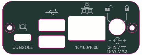

Rear Panel
USRP E310 Rear Panel
  • PWR: Locking connector (Kycon KLDHCX-0202-A-LT) for the USRP-E Series power supply
  • 1G ETH: RJ45 port for Ethernet interfaces
  • USB: USB 2.0 Port
  • SERIAL: Micro USB connection for serial uart console

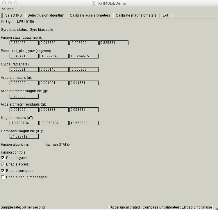

Inertial Measurement Unit (IMU)
Your USRP-E Series device has an onboard IMU that provides 9 axis (Gyro, Accelerometer and compass) functionality.
The USRP-E Series images ship with several example applications based on RTIMULib that allow the user to explore the basic functionality of the IMU as well as to calibrate it.
To test the accelerometer, run:
$ RTIMULibDrive
This will print the current accelerometer values on the console.
To launch the IMU calibration procedure, run:
$ RTIMULibCal
and follow the onscreen instructions. Please note that magnetometer calibration is important to obtain sensible results if the IMU is to be used in sensor fusion applications.
Using X11 forwarding over SSH (see Frequently Asked Questions) a complete sensor fusion application can be run over SSH from a host computer by typing:
$ RTIMULibDemo
This should open a graphical window on the host computer that displays the various outputs of the IMU, as well as quaternion measurements based on different sensor fusion algorithms.
RTIMULibDemo
For more advanced IMU based applications please refer to the RTIMULib repository as well as the datasheets.
