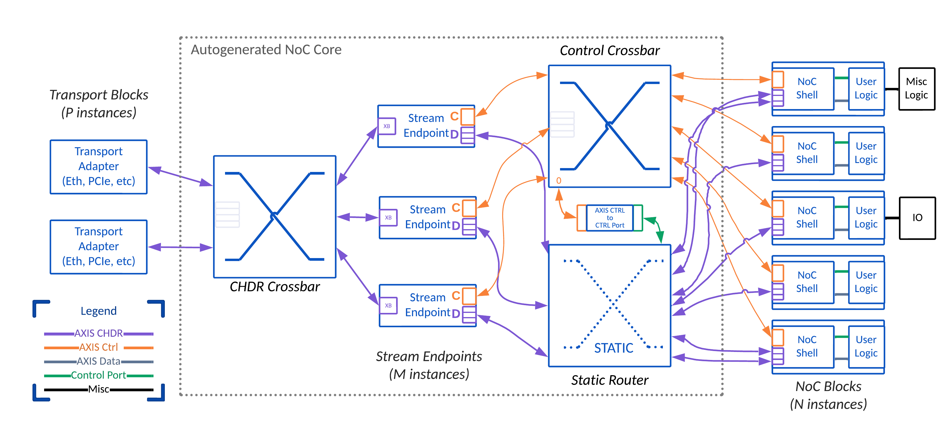

The RFNoC Flow Graph
As shown in the figure below an RFNoC flow graph has the following major components:
  • NoC Blocks
  • Stream Endpoints
  • Transport Adapters
  • Routing Core (Routers and Crossbars).
A typical RFNoC flow graph.
NoC Block
A NoC block contains the core processing IP (user logic) sandboxed from the rest of the blocks and from the framework. The user logic interacts with the RFNoC infrastructure using the NoC Shell module. The NoC shell provides a separate control and data interface that the user logic can use to send and receive control transactions and processing data, respectively. The details of each interface will be covered in later sections. A NoC block may also interface with outside logic or IO that is unmanaged by RFNoC. An RFNoC flow graph can have at most about 1000 NoC blocks per device (if they fit in the FPGA). This maximum number of ports in each FPGA is limited by a 10-bit address field which is shared for blocks, stream endpoints and transports.
Stream Endpoint
A stream endpoint serves as the start and end for a unique sample stream. The number of stream endpoints in a USRP design must scale with the number of parallel streams of data to/from the device. A stream endpoint can exist in the FPGA or in software. A bidirectional stream can be initiated between any two endpoints dynamically at any point in the application. Streams can be destroyed and recreated without having to rebuild or partially reconfigure the FPGA image. RFNoC implements flow control between stream endpoints, so they can flow over any transport. An RFNoC flow graph can have a user-selectable number of stream endpoints. The number of stream endpoints is independent of the number NoC blocks. The stream endpoint can optionally support multiple virtual streams that are multiplexed through the same physical transport. The multiplexing and demultiplexing will be performed by the framework using the "virtual channel" field in the packet header.
Transport Adapter
A transport adapter is a wrapper around a specific transport implementation like Ethernet, Aurora, PCI Express, etc. Transport adapters provide logic to enable RFNoC-formatted dataflow between two FPGAs, or FPGA and software in a hardware-transparent way. The number of stream endpoints is independent of the number of transport adapters; a transport is capable of multiplexing multiple streams of data.
Routing Core
The routing core handles connecting NoC blocks, stream endpoints and transport adapters. The routing core has three main routers:
  • CHDR Crossbar: This crossbar is a full-bandwidth full-mesh dynamic crossbar. It connects the transport adapters to the stream endpoints. The CHDR crossbar enables communication within an FPGA between any two of its crossbar ports. This allows communication between two stream endpoints or between a stream endpoint and another FPGA through a transport adapter.
  • Control Crossbar: This crossbar is a local crossbar, also full-mesh, but with reduced bandwidth. It allows control transactions to be sent between any two of its ports. This allows control transactions to be sent from software to a NoC block, from a NoC block to software, between two NoC blocks, or from a NoC block to another FPGA.
  • Static Router: The static router encodes a fixed topology between data ports of NoC blocks. This topology can only be reconfigured by rebuilding the FPGA image. A static router requires significantly fewer FPGA resources than a dynamic router.

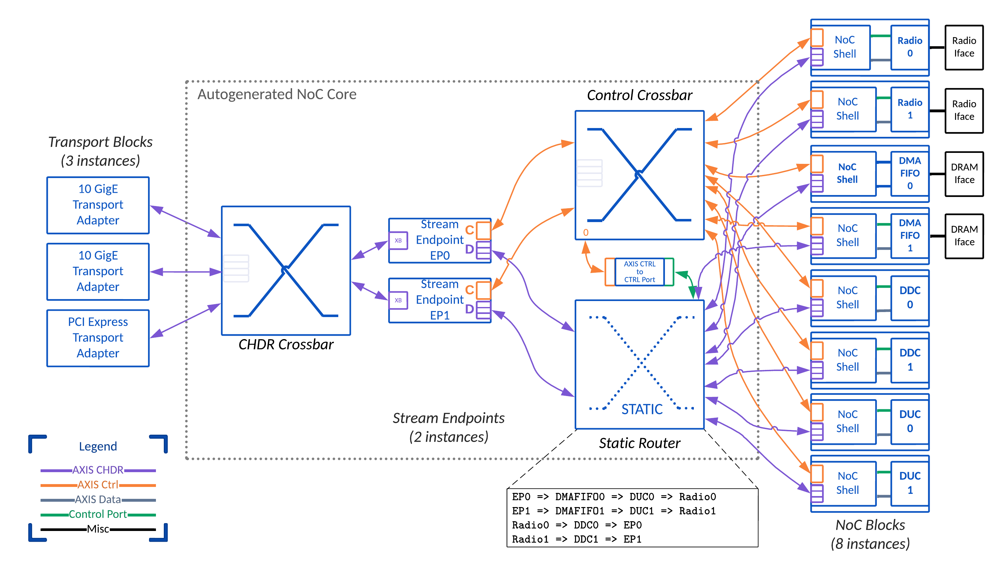

Example Topology
Example topology for a multi_usrp compatible image (X310_XG).
This Figure shows an example topology for the USRP-X310 that can function with the multi_usrp API and a UBX daughter board (i.e., it has all the necessary radio and DSP blocks to implement the API). This design has:
  • 3 transport adapters: 2 for 10 GigE and one for PCIe
  • 2 stream endpoints: Each X310 supports 2 UBX daughter boards with a total 2 transmit and 2 receive channels. So, we instantiate 2 (bidirectional) stream endpoints.
  • 8 NoC blocks: We have 2 each of the radio, DMA FIFO, DDC and DUC blocks. Together they form 4 chains (subgraphs). These chains hook up two of the 4 ports (TX and RX) of the stream endpoints.
  • 2 crossbars: The 8 blocks in this image tunnel through 2 stream endpoints into the 5-port CHDR crossbar. The control crossbar has 11 ports for full control connectivity between blocks and endpoints.
