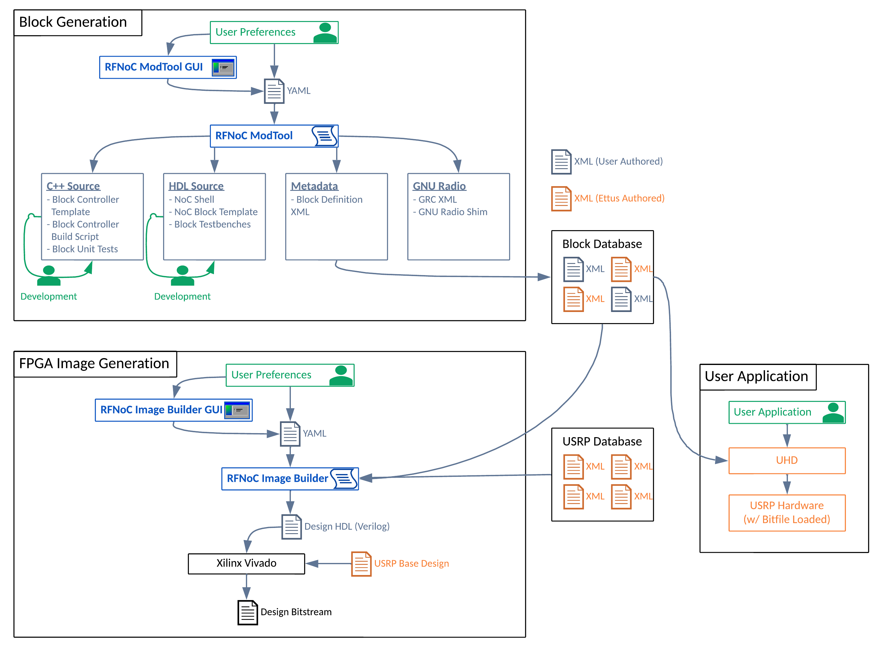

The RFNoC framework provides code generation tools to create blocks and to assemble an FPGA design using existing blocks. All tools have a command line interface (CLI) and graphical user interface (GUI). The block creation tool, called RFNoC ModTool, accepts basic parameters, control-plane parameters, data-plane parameters, and other user options to generate Verilog and C++ code templates for a new block, units tests and the supporting metadata files for design assembly and for use by UHD. After a basic template for a block has been created, users can iteratively develop the FPGA and software implementation for the block, and then move to the next step of design assembly. The design assembly tool, called RFNoC Image Builder, accepts parameters and performs the steps described in the section Design Assembly Toolflow to build an FPGA image that instantiates blocks from the local block database, with connections specified statically at compile time. The generated image can then be deployed onto a USRP for UHD to automatically detect and target the blocks on the device.
User preferences can be communicated using files or GUI actions. The YAML format is used to describe all user-options and the XML format is used for generated files. In almost all cases, it should not be necessary to modify the XML files generated by the tools. The overview and interaction of the tools is shown in the figure below and is described in the following sections.
RFNoC Tool flow Overview
RFNoC ModTool
Overview
RFNoC ModTool should be used to generate a new RFNoC block which may have custom user-defined logic. The FPGA and software interfaces to the block are detailed in Section NoC Block User Interface and Section Block Controller The inputs to RFNoC ModTool are described above, and using these User Preferences, the tool will generate the following files:

RFNoC Image Builder
Overview
RFNoC Image Builder should be used to generate an FPGA design and a bitstream using blocks provided by Ettus Research or created by the user. RFNoC Image Builder will generate Verilog to instantiate blocks requested by the user, connect them and integrate all components with the USRP board support package, to create a full design that can be synthesized and built into a bitstream. The code and the bitstream is the only output of this tool.
The user can interact with RFNoC Image Builder using a GUI or using the CLI and specifying a YAML file with following format.
