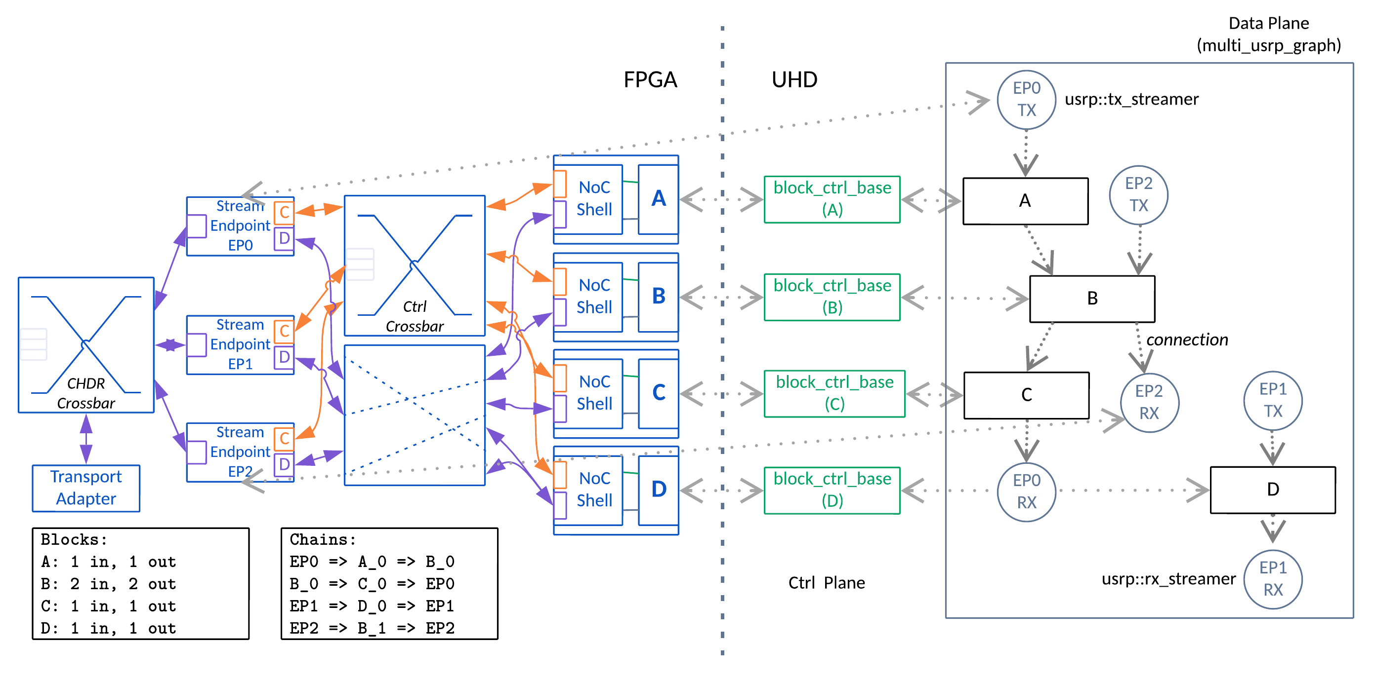

On the software side (UHD) RFNoC has the following interfaces:
  • Block Controller: This is a control interface to each block in the design. Block controllers are discovered automatically by UHD based on the blocks in an FPGA, and they can be retrieved by the user to send and receive commands from blocks.
  • Graph: The graph object manages a topology of blocks in an application. The static connections in the FPGA and the dynamic connections made by the user will be reflected in the graph. The graph will ensure state integrity between blocks if there are inherent dependencies.
  • Streamers: Streamers are used to send/receive data to/from blocks in the FPGA.
Example FPGA and SW objects in an RFNoC graph
