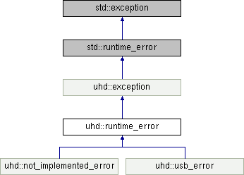

uhd::runtime_error Struct Reference
#include <uhd/exception.hpp>
Inheritance diagram for uhd::runtime_error:
uhd::exception uhd::not_implemented_error uhd::usb_error
