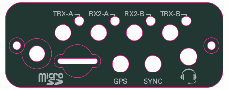

Front Panel
USRP E310 Front panel
  • RF A Group
    • TX/RX LED: Indicates that data is streaming on the TX/RX channel on frontend side A
    • RX2 LED: Indicates that data is streaming on the RX2 channel on frontend side A
  • RF B Group
    • TX/RX LED: Indicates that data is streaming on the TX/RX channel on frontend B
    • RX2 LED: Indicates that data is streaming on the RX2 channel on frontend B
  • PWR: Power switch with integrated status LED, for status description see below.
  • SYNC: Input port for external PPS signal
  • GPS: Connection for the GPS antenna
  • Version 1 (original E310)
    • Off: Indicates device is off and not charging
    • Solid Red: Indicates device is charging
    • Solid Green: Indicates device is on
    • Fast Blinking Red: Indicates an error code
      • 1 - Low voltage error
      • 2 - Regulator low voltage error
      • 3 - FPGA power error
      • 4 - DRAM power error
      • 5 - 1.8V rail power error
      • 6 - 3.3V rail power error
      • 7 - Daughterboard / TX power error
      • 9 - Temperature error
  • Version 2 (E312 and upgraded E310)
    • Slow Blinking Green: Indicates device is off and charging
    • Fast Blinking Green: Indicates device is on and charging
    • Solid Green: Indicates device is on (and not charging, if E312)
    • Solid Orange: Indicates device is on and discharging
    • Fast Blinking Orange: Indicates device is on, discharging, and charge is below 10% charge
      • 8 - Charger error
      • 9 - Charger temperature error
      • 10 - Battery low error
      • 11 - Fuel Gauge temperature error
      • 12 - Global (case) temperature error

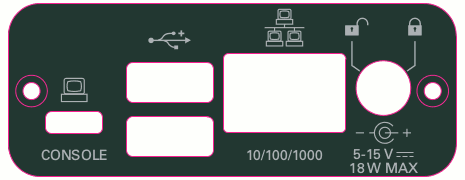

Rear Panel
USRP E310 Rear Panel
  • PWR: Locking connector (Kycon KLDHCX-0202-A-LT) for the USRP-E Series power supply
  • 1G ETH: RJ45 port for Ethernet interfaces
  • USB: USB 2.0 Port
  • SERIAL: Micro USB connection for serial uart console
