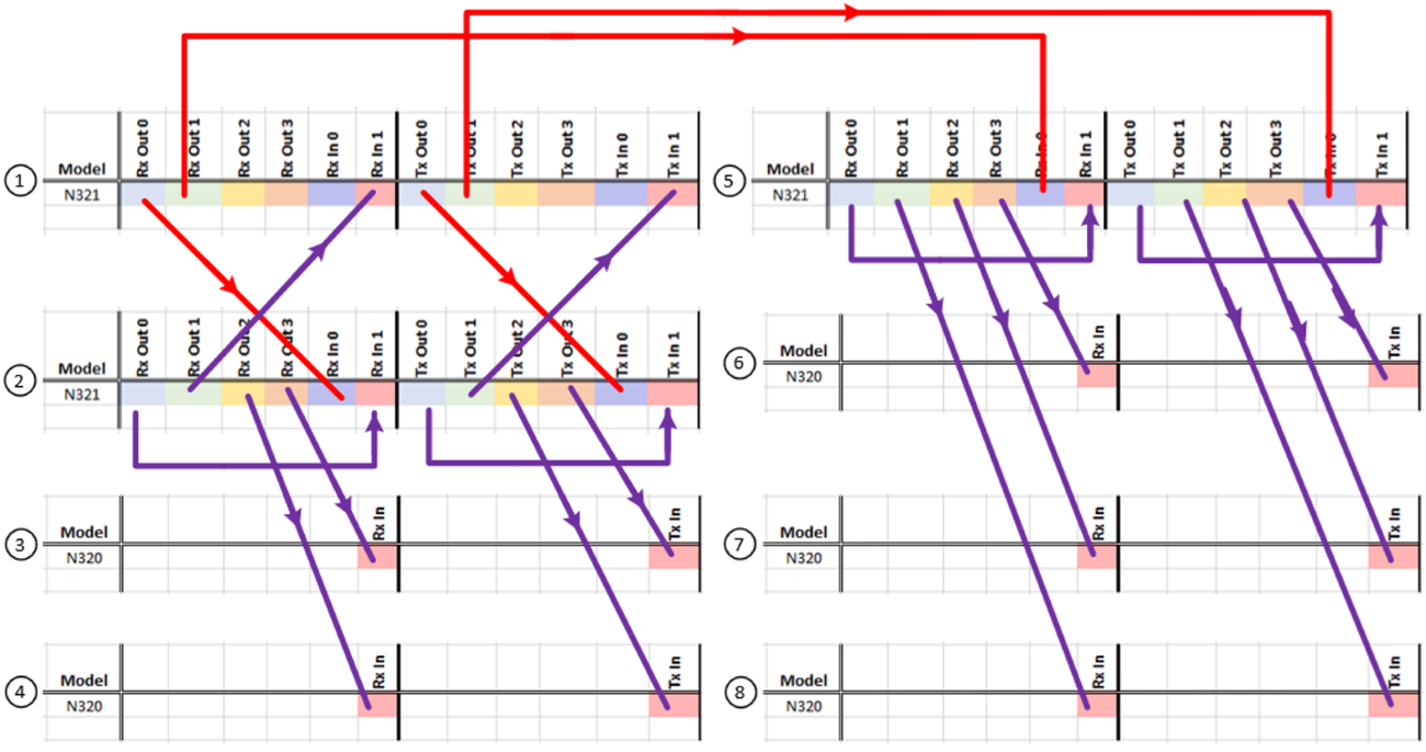

The difference between the N320 and the N321 is in its LO sharing capability. The N320 has a single input for the TX and RX LOs, respectively. The N321 also has the ability to export its LO up to four times, making it possible to share LOs between a large number of N321 devices without having to provide an external, separate LO source. Due to number of connectors required to provide the large number of LO outputs, the N321 does not have a front-panel GPIO connector.

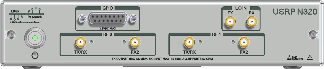

The front panel is used for all RF connections (including the external LO inputs, see External LOs) and all TX/RX connections, as well as the front-panel GPIO (N320 only!).
The connectors labeled RF0 are also referred to as slot A, and the connectors labeled RF1 are also referred as slot B (matching the internal connections to the daughterboard).
N320 Front Panel
N321 Front Panel

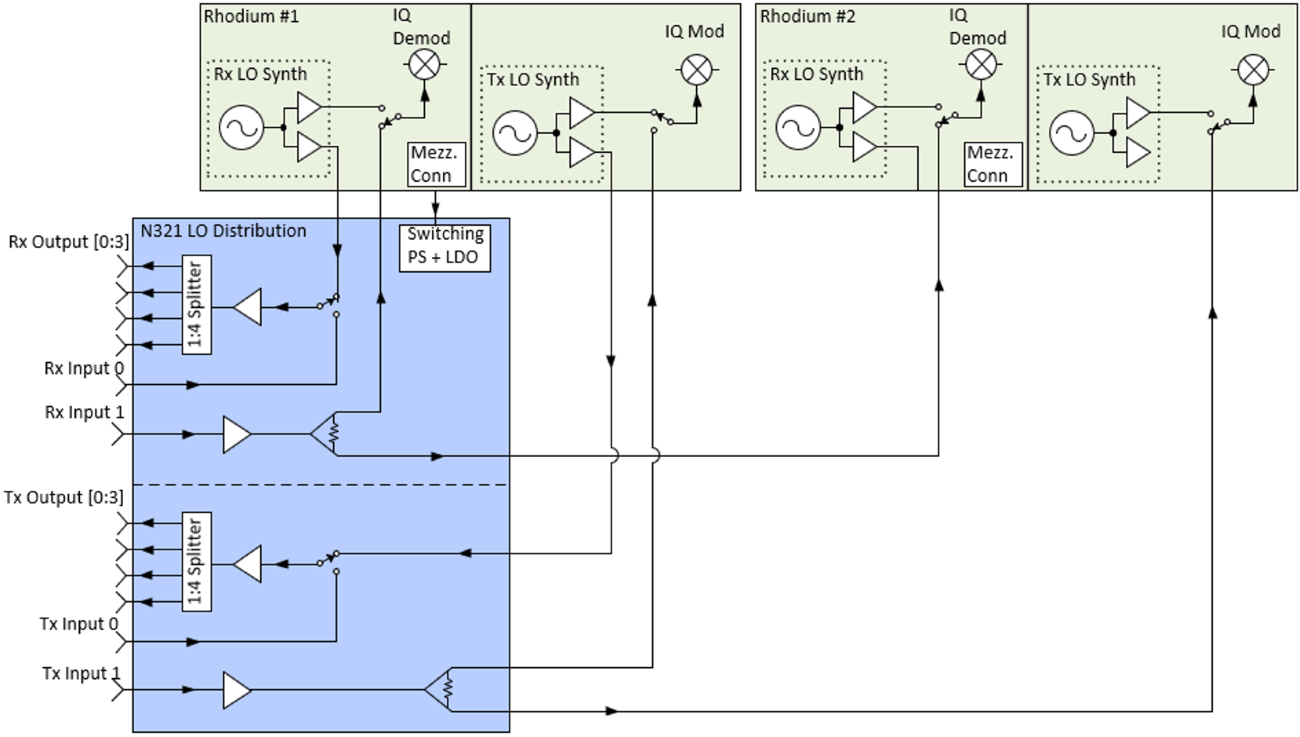

N321 LO Distribution Board
The N321 has an additional board to perform LO signal splitting and distribution. The 4 output ports, OUT0 through OUT3, are driven by a 1:4 splitter which can be sourced from the corresponding IN0 front panel port or the LO on the daughterboard in slot A. To use the IN0 front panel port, set LO export enabled to false. To use the LO located on the daughterboard in slot A, set LO export enabled to true.
Each of the 4 output ports, OUT0 through OUT3, have an internal terminator which must be disabled before use. These can be controlled through the RFNoC radio block's API, the property tree, or directly through commands in the MPM shell.
N321 LO Distribution Diagram
N320/N321 LO Sharing
By using matched length cabling with N321s, up to 16 modules can use both of their RX and TX channels while sharing a single N321's LO signal, resulting in a 32 by 32 channel single shared LO configuration. This 32 by 32 channel configuration can also utilize an external LO signal, allowing an already split external LO signal to support larger configurations of 64 by 64 channels, 128 by 128 channels, and larger.
The following diagram shows the connections necessary to create a 16 by 16 channel configuration with a single shared LO source.
N321 16 Channel LO Sharing
