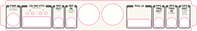

Rear Panel
X3x0 Rear Panel
  • PWR: Connector for the USRP-X Series power supply
  • 1G/10G ETH: SFP+ ports for Ethernet interfaces
  • REF OUT: Output port for the exported reference clock
  • REF IN: Reference clock input
  • PCIe x4: Connector for Cabled PCI Express link
  • PPS/TRIG OUT: Output port for the PPS signal
  • PPS/TRIG IN: Input port for the PPS signal
  • GPS: Connection for the GPS antenna
