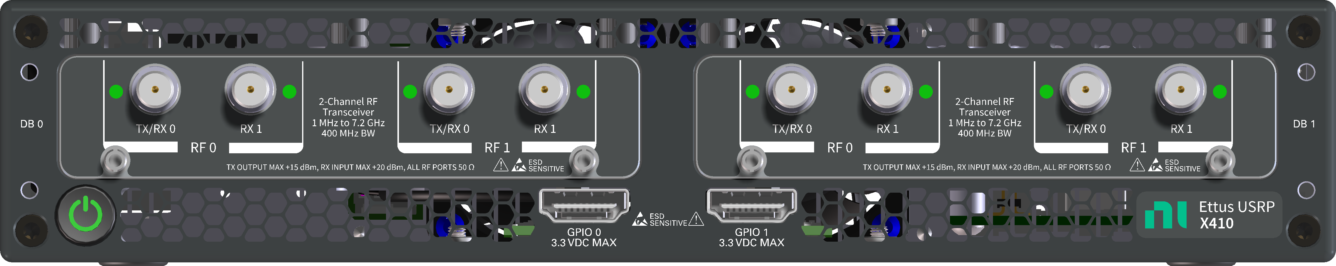

The front panel provides access to the RF connectors (SMA), Tx/Rx status LEDs, programmable GPIOs, and the power button. The rear panel is where the power and data connections go (Ethernet, USB) as well as time/clock reference signals and GPS antenna.

The front panel provides access to the RF ports and status LEDs of the ZBX Daughterboard. It also provides access to the front-panel GPIO connectors (2x HDMI) and the power button.

The RF ports on the front panel of the X410 + ZBX correspond to the following subdev specifications:
Label | Subdev Spec |
DB 0 / RF 0 | A:0 |
DB 0 / RF 1 | A:1 |
DB 1 / RF 0 | B:0 |
DB 1 / RF 1 | B:1 |
The subdev spec slot identifiers "A" and "B" are not reflected on the front panel. They were set to match valid subdev specifications of previous USRPs, maintaining backward compatibility.
These values can be used for uhd::usrp::multi_usrp::set_rx_subdev_spec() and uhd::usrp::multi_usrp::set_tx_subdev_spec() as with other USRPs.
