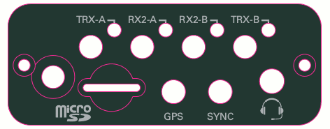

The device provides a 3.3V supply voltage to an external antenna connected to the GPS port of your device. Note that this supply voltage is turned off in order to save power upon destruction of the software object.
Pin 1 is connected to the shared +3.3V power rail and can be used to draw power. The maximum current depends on the power used by the rest of the device, but 300-500 mA is generally safe. It is recommended to monitor the rail voltage when drawing power from this pin.
The pins are as follows:
