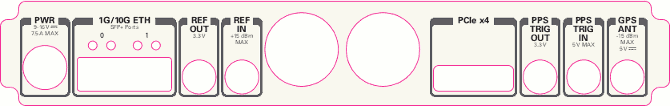

uhd_find_devices).Ettus Research recommends the Intel Ethernet Converged Network Adapter X520-DA2 interface for communication with the USRP X300/X310 device. Installation instructions for this interface are available on the official Intel website.

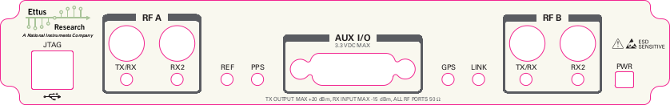

uhd_find_devices).The LEDs on the front panel can be useful in debugging hardware and software issues (see Front Panel)
In order to utilize the X-series USRP over dual 10 Gigabit Ethernet interfaces, ensure either the XG image is installed (see FPGA Image Flavors). In addition to burning the prerequisite FPGA image, it may also be necessary to tune the network interface card (NIC) to eliminate drops (Ds) and reduce overflows (Os). This is done by increasing the number of RX descriptors (see Linux specific notes).

The USRP X3x0 includes an on-board JTAG programmer, built into the motherboard. To connect to this JTAG device, simply connect your computer to the USB JTAG port on the front of the X3x0 device. You may now use the JTAG programmer in the same way you would use any other, including:

| LED | Description | |
| DS1 | 1.2V | power |
| DS2 | TXRX1 | Red: TX, Green: RX |
| DS3 | RX1 | Green: RX |
| DS4 | REF | reference lock |
| DS5 | PPS | flashes on edge |
| DS6 | GPS | GPS lock |
| DS7 | SFP0 | link |
| DS8 | SFP0 | link activity |
| DS10 | TXRX2 | Red: TX Green: RX |
| DS11 | RX2 | Green: RX |
| DS12 | 6V | daughterboard power |
| DS13 | 3.8V | power |
| DS14 | 3.3V | management power |
| DS15 | 3.3V | auxiliary management power |
| DS16 | 1.8V | FPGA power |
| DS16 | 3.3V | FPGA power |
| DS19 | SFP1 | link |
| DS20 | SFP1 | link active |
| DS21 | LINK | link activity |
