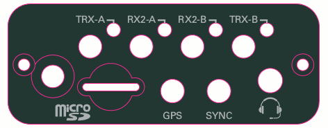

Front Panel
USRP E310 Front panel
  • RF A Group
    • TX/RX LED: Indicates that data is streaming on the TX/RX channel on frontend side A
    • RX2 LED: Indicates that data is streaming on the RX2 channel on frontend side A
  • RF B Group
    • TX/RX LED: Indicates that data is streaming on the TX/RX channel on frontend B
    • RX2 LED: Indicates that data is streaming on the RX2 channel on frontend B
  • PWR: Power switch with integrated status LED, for status description see below.
  • SYNC: Input port for external PPS signal

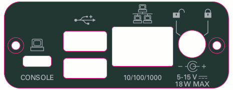

Rear Panel
USRP E310 Rear Panel
  • PWR: Locking connector (Kycon KLDHCX-0202-A-LT) for the USRP-E Series power supply
  • 1G ETH: RJ45 port for Ethernet interfaces
  • USB: USB 2.0 Port
  • SERIAL: Micro USB connection for serial uart console
