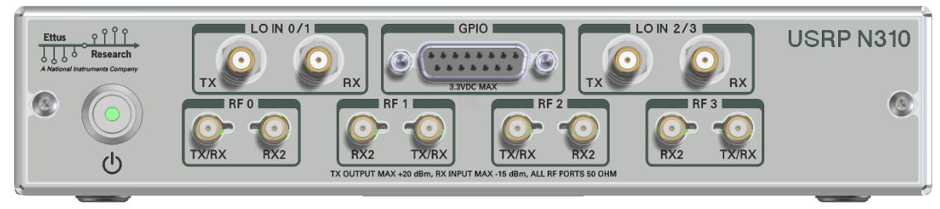

The N310 is a 4-channel transmitter/receiver based on the AD9371 transceiver IC. It has two daughterboards with one AD9371 each; every daughterboard provides two RF channels. Note that the product code "N310" refers to the module consisting of mother- and daughterboard, the daughterboard itself is referred to by its codename, "Magnesium".
The N300 is a subset of the N310. It has 2 TX/RX channels (on a single daughterboard; the daughterboard itself is the same as the N310) and a smaller FPGA (XCZ035). Also, it does not have connectors for external LOs.

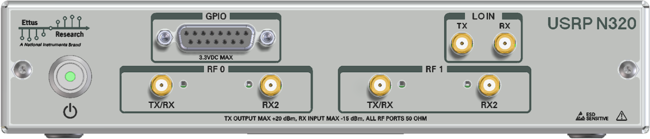

The N320 is a 2-channel transmitter/receiver using discrete components instead of an RFIC. It has two daughterboards, each has one ADC/DAC and provides one RF channel.

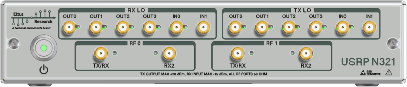

The difference between the N320 and the N321 is in its LO sharing capability. The N320 has a single input for the TX and RX LOs, respectively. The N321 also has the ability to export its LO up to four times, making it possible to share LOs between a large number of N321 devices without having to provide an external, separate LO source. Due to number of connectors required to provide the large number of LO outputs, the N321 does not have a front-panel GPIO connector.
The N320 has a higher maximum analog bandwidth than the N310. It can provide rates up to 250 Msps, resulting in a usable analog bandwidth of up to 200 MHz. In order to better use the high available rates, the N320/N321 devices have an additional QSFP+ connector on the back panel which can be used for streaming data to and from the radios. In order to facilitate the higher bandwidth, UHD uses a technology called Data Plane Development Kit (DPDK). See the DPDK page for details on how it can improve streaming, and how to use it.

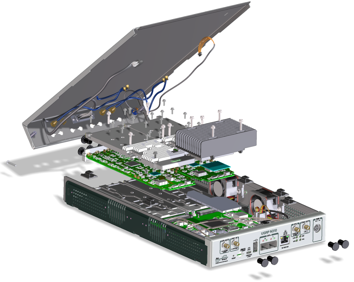

The main CPU of the N310 is a Xilinx Zynq SoC XC7Z100 (exception: The N300). It is both a dual-core ARM Cortex A9 CPU and Kintex-7 FPGA on a single die. The CPU is clocked at 800 MHz (speedgrade 2).
The programmable logic (PL, or FPGA) section of the SoC is responsible for handling all sampling data, the 10 GigE network connections, and any other high-speed utility such as custom RFNoC logic. The processing system (PS, or CPU) is running a custom-build OpenEmbedded-based Linux operating system. The OS is responsible for all the device and peripheral management, such as running MPM, configuring the network interfaces, running local UHD sessions, etc.
The STM32 microcontroller controls various low-level features of the N3xx series motherboard: It controls the power sequencing, reads out fan speeds and some of the temperature sensors. It is connected to the Zynq via an I2C bus.
The N3XX series uses a micro SD card as its main storage. The entire root file system (Linux kernel, libraries) and any user data are stored on this SD card.

The RF ports on the front panel of the N300/N310 correspond to the following subdev specifications:
| Label | Subdev Spec |
| RF0 | A:0 |
| RF1 | A:1 |
| RF2 | B:0 (N310 only) |
| RF3 | B:1 (N310 only) |
The RF ports on the front panel of the N320/N321 correspond to the following subdev specifications:
| RF0 | A:0 |
| RF1 | B:0 |

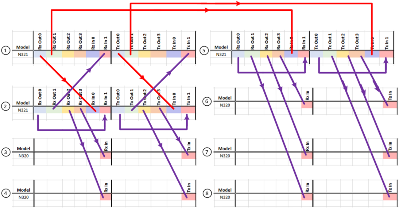

To choose a source for clock (frequency) and PPS (time), use the clock_source and time_source device arguments just like with any other USRP (see also Device Synchronization). The following combinations are supported:
clock_source  | time_source  | Notes |
internal  | internal  | Default value |
external  | internal  | The PPS will be generated from the reference signal, but this does not allow time synchronization between devices. |
external  | external  | The device assumes that the external reference clock and PPS are synchronized. |
gpsdo  | gpsdo  | This will work even without GPS reception (see below). |
The combination of clock_source=external,time_source=gpsdo is not available out of the box, but can be enabled by patching the MPM source code (n3xx.py). This is considered an advanced and unsupported use case. Read the appropriate source code for a description of drawbacks. Using this mode will cause unreliable phase alignment.
See the following sections for more details on the individual synchronization options.

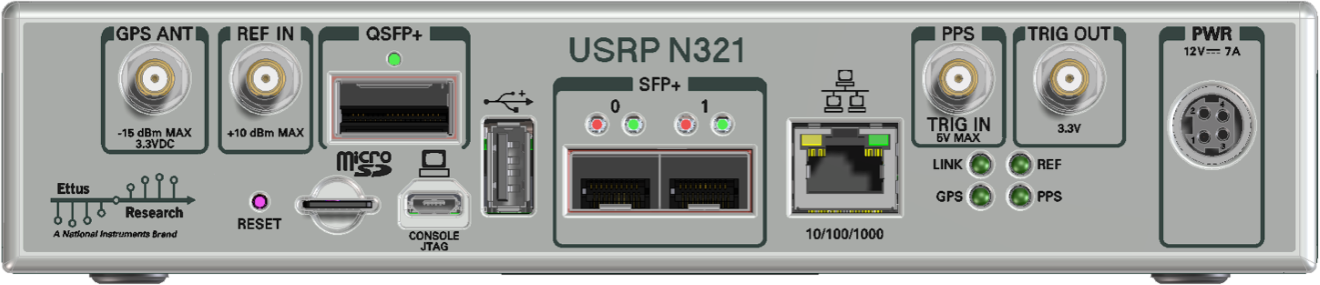

The N3xx series has an onboard GPSDO as well as a 25 MHz reference oscillator, which can both be used as time- and clock references. The GPSDO will function as a reference even when there is no GPS reception. It can be powered off to reduce power usage and interference by supplying the enable_gps=0 option in the configuration file (in this case, gpsdo cannot be used as a time or clock reference).
Note that this does not enable the synchronization of multiple devices. Using an internal reference is the default.
In order to synchronize multiple USRPs, an external reference, such as the CDA-2990 (OctoClock), is required. If only a clock reference is available, it is possible to derive an internal PPS signal from the reference (which will allow devices to share a frequency, but not a time reference). If both an external clock and time source are provided, devices will be synchronized in frequency and time.
 To reduce phase noise, it may be necessary to power down the GPSDO when using an external reference. To do this, just add enable_gps=False to the configuration file in /etc/uhd/mpm.conf (see also Configuration Files).

Note: The N321 does not have a front-panel GPIO due to lack of panel space.
Note: Unlike the X300 series, the N3XX series does not have user-programmable daughterboard GPIOs. The front-panel GPIOs can still be used to track the ATR state of the radios, though (see below).
The USRP N3xx series has 12 programmable GPIO pins, accessible through the DB15 connector on the front panel. The front-panel GPIO on the N3xx series has a programmable source per pin. For every pin, it is possible to either drive it from the PS (i.e., from Linux), or via UHD.

Like the USRP X300 series, the N310 has connectors on both the front and back panel. The back panel holds the power connector, all network connections, USB connections for serial console (see Serial connection), JTAG, peripherals, SMA connectors for GPS antenna input, 10 MHz clock reference, PPS time reference input and output (TRIG in/out), the slot for the SD card (see also The SD card), and indicator LEDs.
The following indicator LEDs are used:
The front panel is used for all RF connections (including the external LO inputs, see External LOs) and all TX/RX connections, as well as the front-panel GPIO.
The connectors labeled RF0 and RF1 are also referred to as slot A, and the connectors labeled RF2 and RF3 are also referred as slot B (matching the internal connections to the daughterboard. Every slot is powered by a single AD9371 RFIC).

The N310 module consists of three PCBs: The motherboard and two daughterboards. Every PCB has a hardware revision number. Modules are always assembled such that the daughterboards have the same revision number. The module revision number is derived from the combination of daughterboard and motherboard hardware revisions. The following table explains which module revision contains which PCB revisions:
| Module Revision | Motherboard Revision | Daughterboard Revision | Minimum UHD Version |
| A | D | D | 3.11.0.0 |
| B | F | E | 3.12.0.0 |
| C | G | E | 3.13.0.2 |
| D | H | E | 3.14.0.0 |
The module revision is printed on the sticker on the underside of an N310 module chassis, it is contained within the part number. For example, if the sticker says "P/N: 141064A-01L", it is a revision A module.

Like the USRP X300 series, the N320/N321 has connectors on both the front and back panel. The back panel holds the power connector, all network connections, USB connections for serial console (see Serial connection), JTAG, peripherals, SMA connectors for GPS antenna input, 10 MHz clock reference, PPS time reference input and output (TRIG in/out), the slot for the SD card (see also The SD card), and indicator LEDs.
The rear panel is identical between the N320 and the N321 with the exception of the product name above the SFP+ connectors.
The front panel is used for all RF connections (including the external LO inputs, see External LOs) and all TX/RX connections, as well as the front-panel GPIO (N320 only!).
The connectors labeled RF0 are also referred to as slot A, and the connectors labeled RF1 are also referred as slot B (matching the internal connections to the daughterboard).

The N320/N321 can utilize an external LO that is connected to the front panel connectors. For the N320, the LO IN TX and LO IN RX connectors are used. For the N321, the RX LO IN1 and TX LO IN1 connectors are used. One or both daughterboards may use this external LO signal by setting the channel's LO source to "external". When the source is set to "external", reading the LO frequency will return the ideal frequency for an external LO source.
The nominal LO input level is +5 dBm. Actual LO input levels should be within +/- 2 dB of that value (i.e., between +3 dBm and +7 dBm).

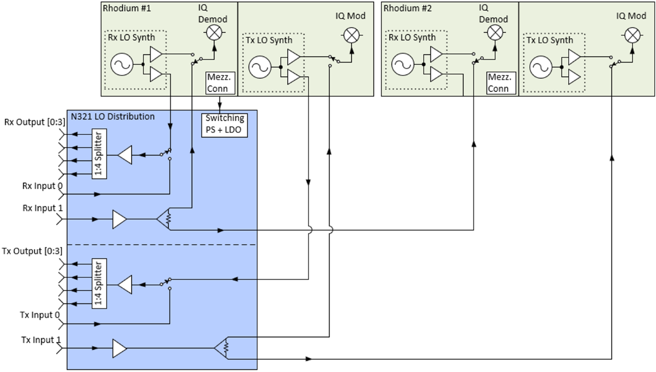

The N321 has an additional board to perform LO signal splitting and distribution. The 4 output ports, OUT0 through OUT3, are driven by a 1:4 splitter which can be sourced from the corresponding IN0 front panel port or the LO on the daughterboard in slot A. To use the IN0 front panel port, set LO export enabled to false. To use the LO located on the daughterboard in slot A, set LO export enabled to true.
Each of the 4 output ports, OUT0 through OUT3, have an internal terminator which must be disabled before use. These can be controlled through the RFNoC radio block's API, the property tree, or directly through commands in the MPM shell.
By using matched length cabling with N321s, up to 16 modules can use both of their RX and TX channels while sharing a single N321's LO signal, resulting in a 32 by 32 channel single shared LO configuration. This 32 by 32 channel configuration can also utilize an external LO signal, allowing an already split external LO signal to support larger configurations of 64 by 64 channels, 128 by 128 channels, and larger.
The following diagram shows the connections necessary to create a 16 by 16 channel configuration with a single shared LO source.
