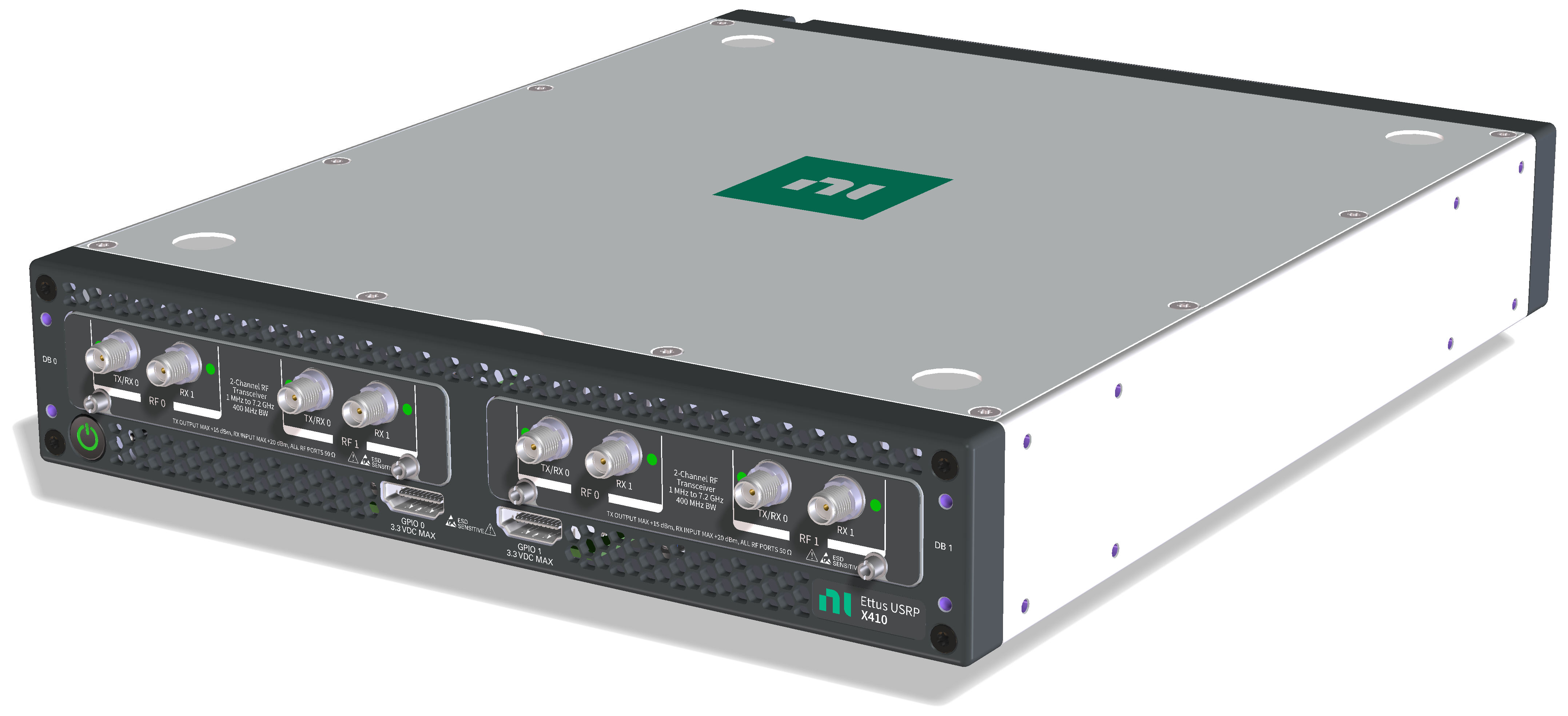

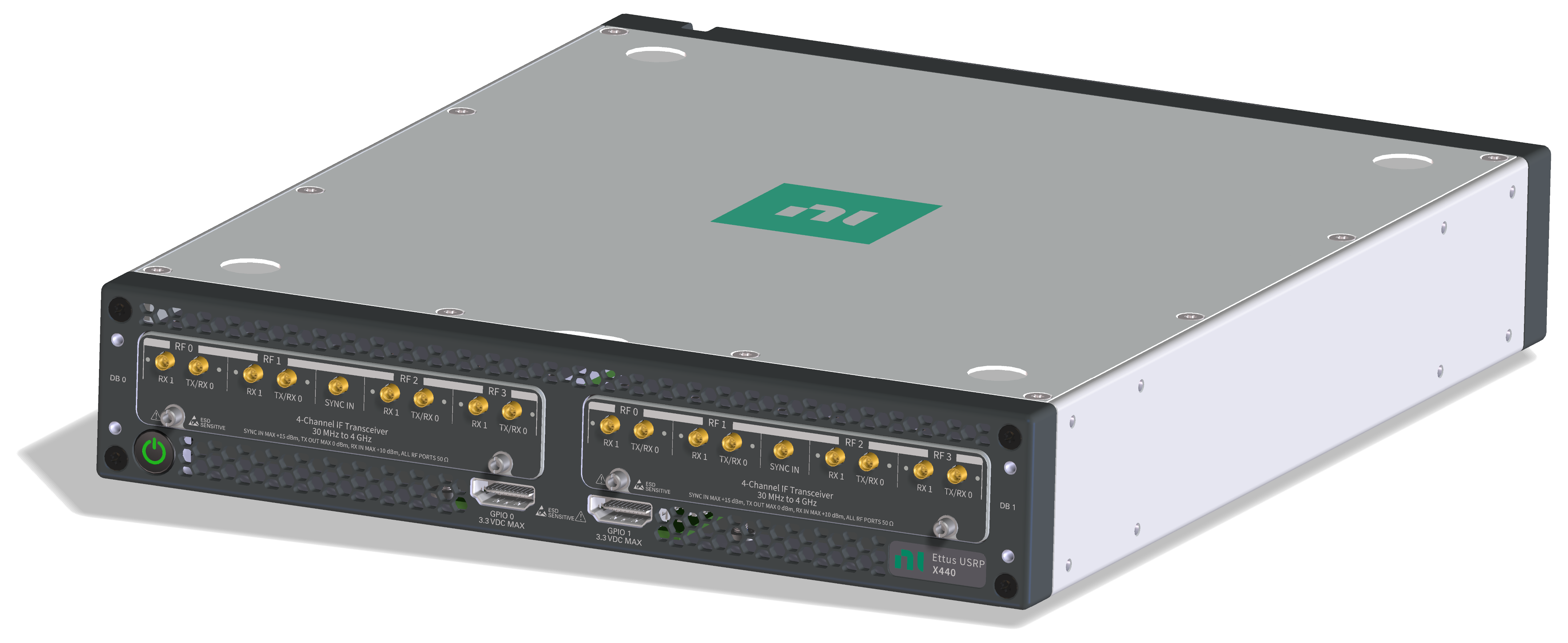

The X4x0 series of USRPs comes in two variants: The USRP X410, and the USRP X440. Both variants share the same enclosure and motherboard, and are collectively referred to as X4x0.
The Ettus USRP X4x0 is a fourth-generation Software Defined Radio (SDR) out of the USRP family of SDRs. Depending on the variant, it contains either two ZBX Daughterboards for a total of 4 channels at up to 400 MHz of analog bandwidth each, or two FBX Daughterboards for a total of 8 channels at up to 1.6 GHz of analog bandwidth. The analog features of the ZBX Daughterboard and the FBX Daughterboard are described in a separate manual page.
The USRP X4x0 features a Xilinx RFSoC, running an embedded Linux system. Like other USRPs, it is addressable through a 1 GbE RJ45 connector, which allows full access to the embedded Linux system, as well as data streaming at low rates. In addition, it features two QSFP28 connectors, which allow for up to 4x10 GbE or 1x100 GbE connections each. The RFSoC used on the USRP X410 is a ZU28DR speed grade 1, on the USRP X440 the ZU28DR speed grade 2.
The front panel provides access to the RF connectors (SMA for X410, MMCX for X440), Tx/Rx status LEDs, programmable GPIOs, and the power button. The rear panel is where the power and data connections go (Ethernet, USB) as well as time/clock reference signals and GPS antenna.

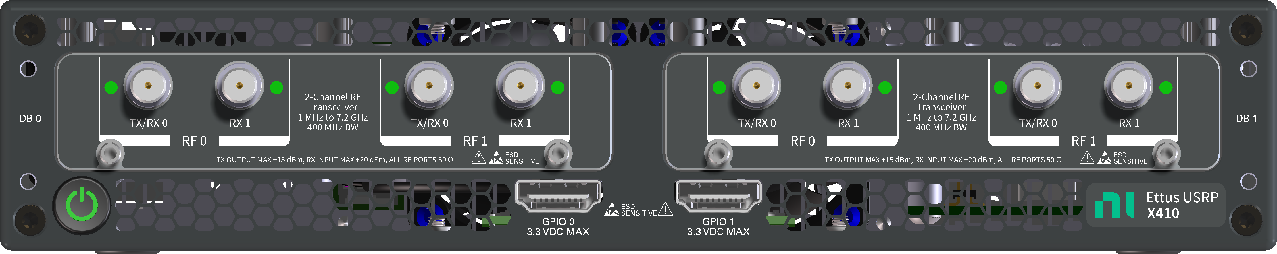

The Ettus USRP X410 contains two ZBX daughterboards. To find out more about the capabilities of these analog front-end cards, see ZBX Daughterboard.

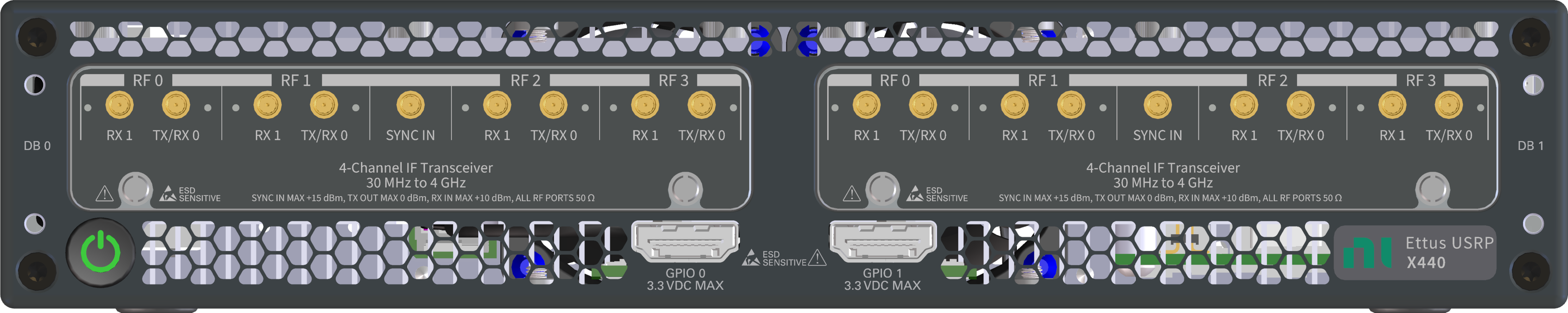

The Ettus USRP X440 contains two FBX daughterboards. Unlike the ZBX daughterboards, they have no analog mixers or filters, but directly connect the converters to the RF connectors. To find out more about the capabilities of these analog front-end cards, see FBX Daughterboard.
The X410 front panel provides access to the RF ports and status LEDs of the ZBX Daughterboard. It also provides access to the front-panel GPIO connectors (2x HDMI) and the power button.
The X440 front panel provides access to the RF ports and status LEDs of the FBX Daughterboard. It also provides access to the front-panel GPIO connectors (2x HDMI) and the power button.

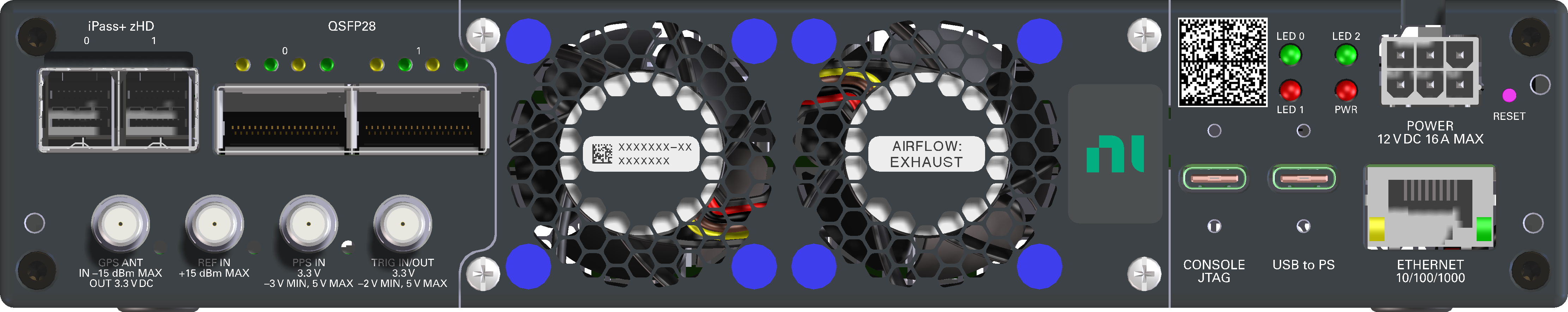

The back panel provides access to power, data connections, clocking and timing related connections, and some status LEDs:
The back panel is identical between X4x0 variants.

The RF ports on the front panel of the X410 + ZBX correspond to the following subdev specifications:
| Label | Subdev Spec |
| DB 0 / RF 0 | A:0 |
| DB 0 / RF 1 | A:1 |
| DB 1 / RF 0 | B:0 |
| DB 1 / RF 1 | B:1 |
The RF ports on the front panel of the X440 + FBX (xx_400 images) correspond to the following subdev specifications:
| DB 0 / RF 0 | A:0 |
| DB 0 / RF 1 | A:1 |
| DB 0 / RF 2 | A:2 |
| DB 0 / RF 3 | A:3 |
| DB 1 / RF 0 | B:0 |
| DB 1 / RF 1 | B:1 |
| DB 1 / RF 2 | B:2 |
| DB 1 / RF 3 | B:3 |
The RF ports on the front panel of the X440 + FBX (xx_1600 images) correspond to the following subdev specifications (Note: The xx_1600 images enable the use of only 2 channels, corresponding to the first channel of each daughterboard):
| DB 0 / RF 0 | A:0 |
| DB 1 / RF 0 | B:0 |
The subdev spec slot identifiers "A" and "B" are not reflected on the front panel. They were set to match valid subdev specifications of previous USRPs, maintaining backward compatibility.
These values can be used for uhd::usrp::multi_usrp::set_rx_subdev_spec() and uhd::usrp::multi_usrp::set_tx_subdev_spec() as with other USRPs.

The USRP X4x0's PWR LED is reserved to visually indicate the user the device's power state. Power LED Behavior describes what each LED state represents.
PWR LED State  | Meaning |
| Off | No power is applied |
| Amber | Power is good but X4x0 is powered off |
| Green | Power is good and X4x0 is powered on |
| Red | Power error state |
The USRP X4x0's user-configurable rear panel status LEDs (LED 0, LED 1, and LED 2) allow the user to have visual indication of various device conditions. Supported LED Behaviors provides a complete list of the supported behaviors for each user-configurable LED. By default, these LEDs are configured as described in LEDs Default Behavior.
The user may alter the default LEDs behavior either temporarily or persistently, see Temporarily change the LED Behavior or Persistently change the LED Behavior accordingly.
activity: flash green LED for CPU activityemmc: flash green LED for eMMC activityheartbeat: flash green LED with a heartbeatfpga: change LED to green when FPGA is loadednetdev <interface>: green LED indicates interface link, amber indicates activity<interface> is the name of any network interface (e.g. eth0)none: LED is constantly offpanic: red LED turns on when kernel panicsuser0: off, green, red or amber LED state is controlled by FPGA application, see Using FPGA LED Controluser1: off, green, red or amber LED state is controlled by FPGA application, see Using FPGA LED Controluser2: off, green, red or amber LED state is controlled by FPGA application, see Using FPGA LED Control| LED Number | Default Behavior |
| LED 0 | heartbeat  |
| LED 1 | fpga  |
| LED 2 | emmc  |
A user may change the X4x0 LEDs' default behavior via running a utility on the on-board ARM processor (Linux).
ledctrl utility to configure each LED based on desired supported behavior: ledctrl <led> <command>
Where <led> valid options are: led0, led1, and led2. These options correspond to the rear panel labels. The <command> valid options are listed in the Supported LED Behaviors section above, with their corresponding description.
Example:
root@ni-x4xx-1111111:~# ledctrl led0 user0
Sets the X4x0's LED 0 to be controlled via the FPGA application using "User LED 0".
The above method will not persist across reboots. In order to persist the changes, modify the ledctrl service unit files which are run by the init system at boot. These files can be found on a running filesystem at, e.g., /lib/systemd/system/ledctrl-led0.service.
When selecting user0, user1, and/or user2 as LED behavior (see Supported LED Behaviors above), the FPGA application gains control of that given LED. The following paragraph describes how the FPGA application can control the state for each setting.
FPGA application access to User LED 0-2 requires modification of the FPGA source code and is achieved directly via Verilog, using a 2-bit vector to control the state.
Below is an excerpt of the FPGA source code, setting the user0, user1, and user2 values to green, red, and amber respectively.
