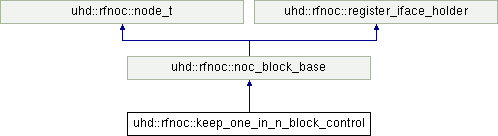

#include <uhd/rfnoc/keep_one_in_n_block_control.hpp>
| virtual size_t | get_max_n () const =0 |
| virtual size_t | get_n (const size_t chan=0) const =0 |
| virtual void | set_n (const size_t n, const size_t chan=0)=0 |
| virtual mode | get_mode (const size_t chan=0) const =0 |
| virtual void | set_mode (const mode mode, const size_t chan=0)=0 |
| static const uint32_t | REG_N_OFFSET |
| static const uint32_t | REG_MODE_OFFSET |
| static const uint32_t | REG_WIDTH_N_OFFSET |
Keep One in N Block Control Class
