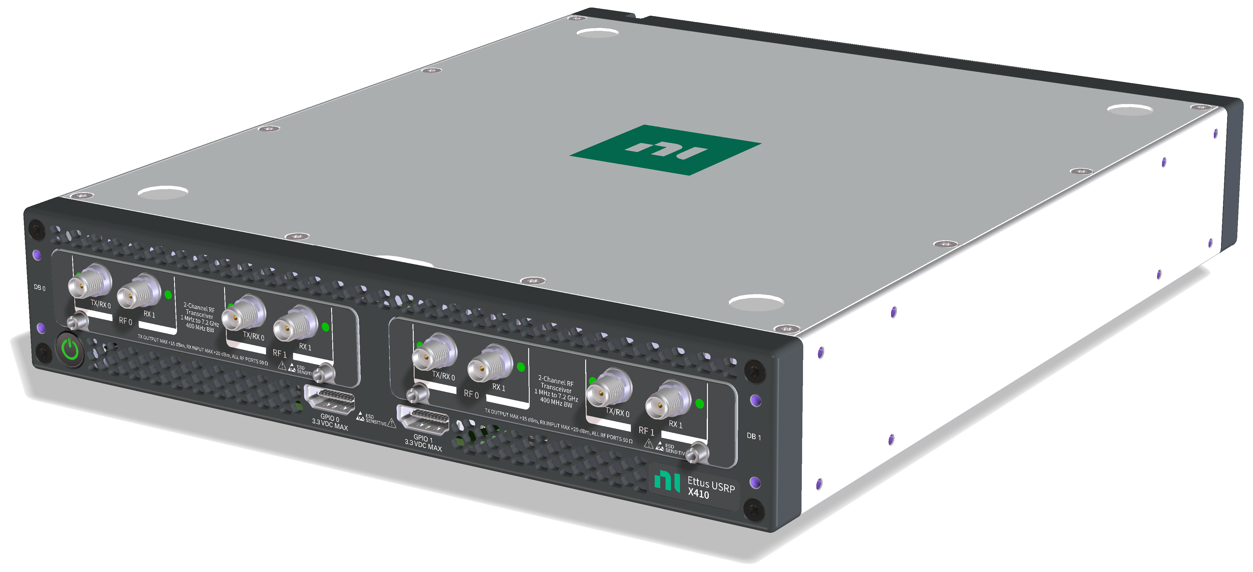

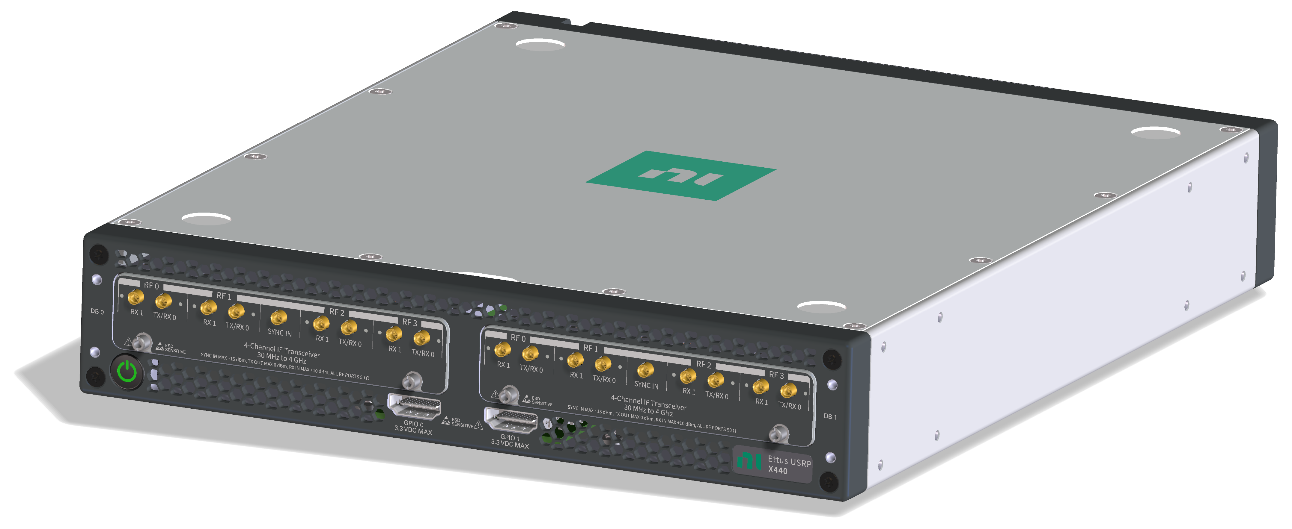

The X4x0 series of USRPs comes in two variants: The USRP X410, and the USRP X440. Both variants share the same enclosure and motherboard, and are collectively referred to as X4x0.
The Ettus USRP X4x0 is a fourth-generation Software Defined Radio (SDR) out of the USRP family of SDRs. Depending on the variant, it contains either two ZBX Daughterboards for a total of 4 channels at up to 400 MHz of analog bandwidth each, or two FBX Daughterboards for a total of 8 channels at up to 1.6 GHz of analog bandwidth. The analog features of the ZBX Daughterboard and the FBX Daughterboard are described in a separate manual page.
The USRP X4x0 features a Xilinx RFSoC, running an embedded Linux system. Like other USRPs, it is addressable through a 1 GbE RJ45 connector, which allows full access to the embedded Linux system, as well as data streaming at low rates. In addition, it features two QSFP28 connectors, which allow for up to 4x10 GbE or 1x100 GbE connections each. The RFSoC used on the USRP X410 is a ZU28DR speed grade 1, on the USRP X440 the ZU28DR speed grade 2.
The front panel provides access to the RF connectors (SMA for X410, MMPX for X440), Tx/Rx status LEDs, programmable GPIOs, and the power button. The rear panel is where the power and data connections go (Ethernet, USB) as well as time/clock reference signals and GPS antenna.
The main chip (the SoC) of the X4x0 is a Xilinx Zynq UltraScale+ RFSoC (ZU28DR). It contains an ARM quad-core Cortex A53 CPU (referred to as the "APU"), an UltraScale+ FPGA including peripherals such as built-in data converters and SD-FEC cores, and an ARM Cortex-R5F real-time processor (the "RPU").

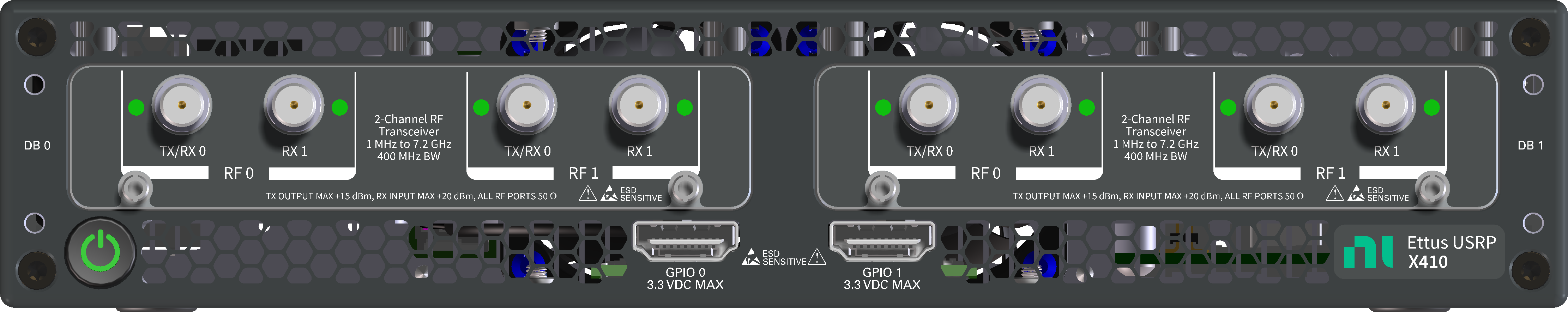

The X410 front panel provides access to the RF ports and status LEDs of the ZBX Daughterboard. It also provides access to the front-panel GPIO connectors (2x HDMI) and the power button.

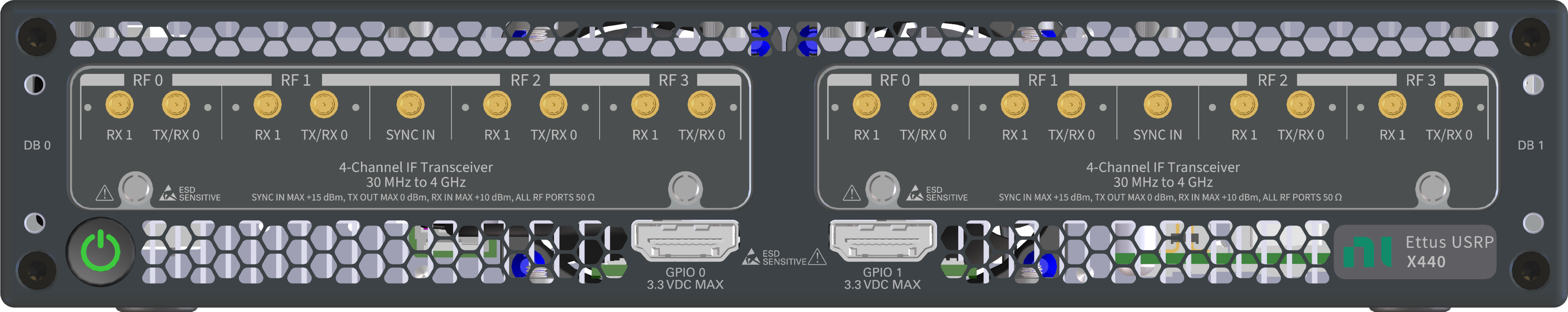

The X440 front panel provides access to the RF ports and status LEDs of the FBX Daughterboard. It also provides access to the front-panel GPIO connectors (2x HDMI) and the power button.

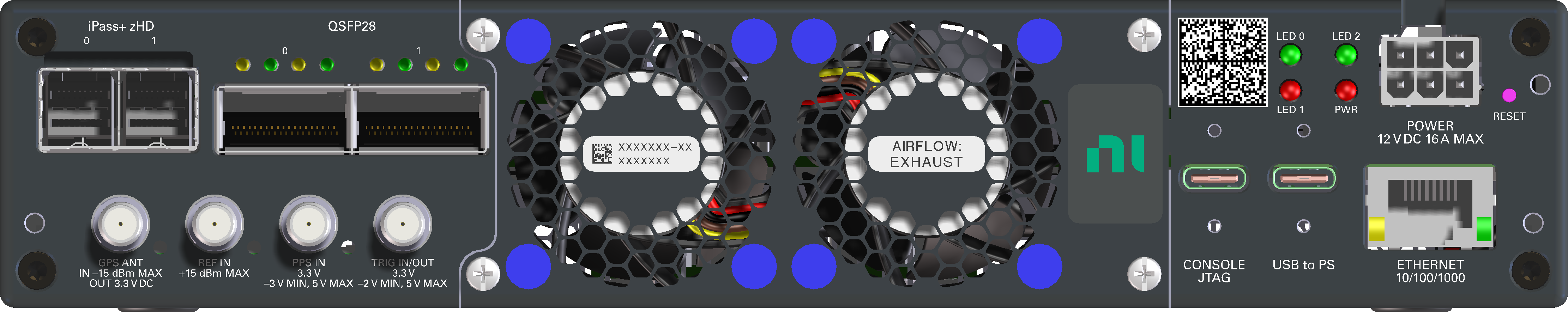

The back panel provides access to power, data connections, clocking and timing related connections, and some status LEDs:
The back panel is identical between X4x0 variants.

The RF ports on the front panel of the X410 + ZBX correspond to the following subdev specifications:
| Label | Subdev Spec |
| DB 0 / RF 0 | A:0 |
| DB 0 / RF 1 | A:1 |
| DB 1 / RF 0 | B:0 |
| DB 1 / RF 1 | B:1 |
The RF ports on the front panel of the X440 + FBX (xx_400 images) correspond to the following subdev specifications:
| DB 0 / RF 0 | A:0 |
| DB 0 / RF 1 | A:1 |
| DB 0 / RF 2 | A:2 |
| DB 0 / RF 3 | A:3 |
| DB 1 / RF 0 | B:0 |
| DB 1 / RF 1 | B:1 |
| DB 1 / RF 2 | B:2 |
| DB 1 / RF 3 | B:3 |

The USRP X4x0's PWR LED is reserved to visually indicate the user the device's power state. Power LED Behavior describes what each LED state represents.
PWR LED State | Meaning |
| Off | No power is applied |
| Amber | Power is good but X4x0 is powered off |
| Green | Power is good and X4x0 is powered on |
| Red | Power error state |
The USRP X4x0's user-configurable rear panel status LEDs (LED 0, LED 1, and LED 2) allow the user to have visual indication of various device conditions. Supported LED Behaviors provides a complete list of the supported behaviors for each user-configurable LED. By default, these LEDs are configured as described in LEDs Default Behavior.
The user may alter the default LEDs behavior either temporarily or persistently, see Temporarily change the LED Behavior or Persistently change the LED Behavior accordingly.
activity: flash green LED for CPU activityemmc: flash green LED for eMMC activityheartbeat: flash green LED with a heartbeatfpga: change LED to green when FPGA is loadednetdev <interface>: green LED indicates interface link, amber indicates activity<interface> is the name of any network interface (e.g. eth0)none: LED is constantly offpanic: red LED turns on when kernel panicsuser0: off, green, red or amber LED state is controlled by FPGA application, see Using FPGA LED Controluser1: off, green, red or amber LED state is controlled by FPGA application, see Using FPGA LED Controluser2: off, green, red or amber LED state is controlled by FPGA application, see Using FPGA LED Control| LED Number | Default Behavior |
| LED 0 | heartbeat |
| LED 1 | fpga |
| LED 2 | emmc |
