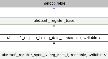

Inheritance diagram for uhd::soft_register_t< reg_data_t, readable, writable >:
uhd::soft_register_base uhd::soft_register_sync_t< reg_data_t, readable, writable >
