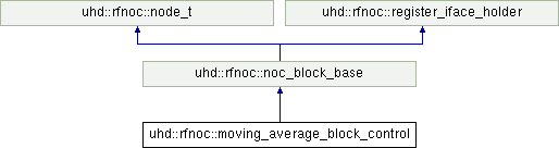

Inheritance diagram for uhd::rfnoc::moving_average_block_control:
