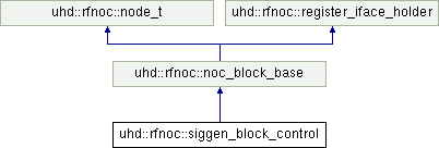

Inheritance diagram for uhd::rfnoc::siggen_block_control:
