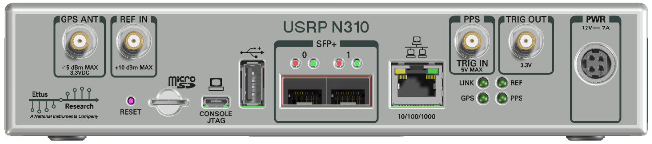

The N310 is a 4-channel transmitter/receiver based on the AD9371 transceiver IC. It has two daughterboards with one AD9371 each; every daughterboard provides two RF channels. Note that the product code "N310" refers to the module consisting of mother- and daughterboard, the daughterboard itself is referred to by its codename, "Magnesium".
The N300 is a subset of the N310. It has 2 TX/RX channels (on a single daughterboard; the daughterboard itself is the same as the N310) and a smaller FPGA (XCZ035). Also, it does not have connectors for external LOs.

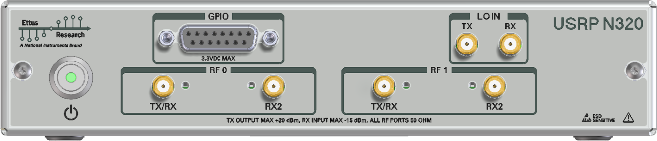

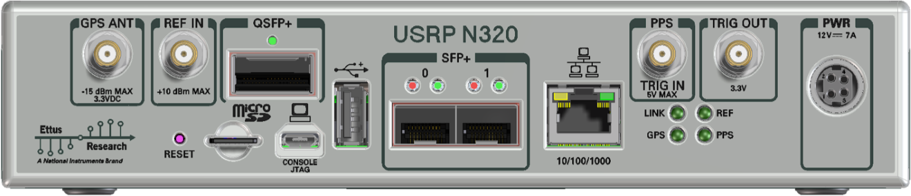

The N320 is a 2-channel transmitter/receiver using discrete components instead of an RFIC. It has two daughterboards, each has one ADC/DAC and provides one RF channel.

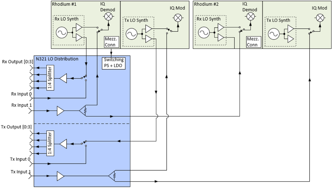

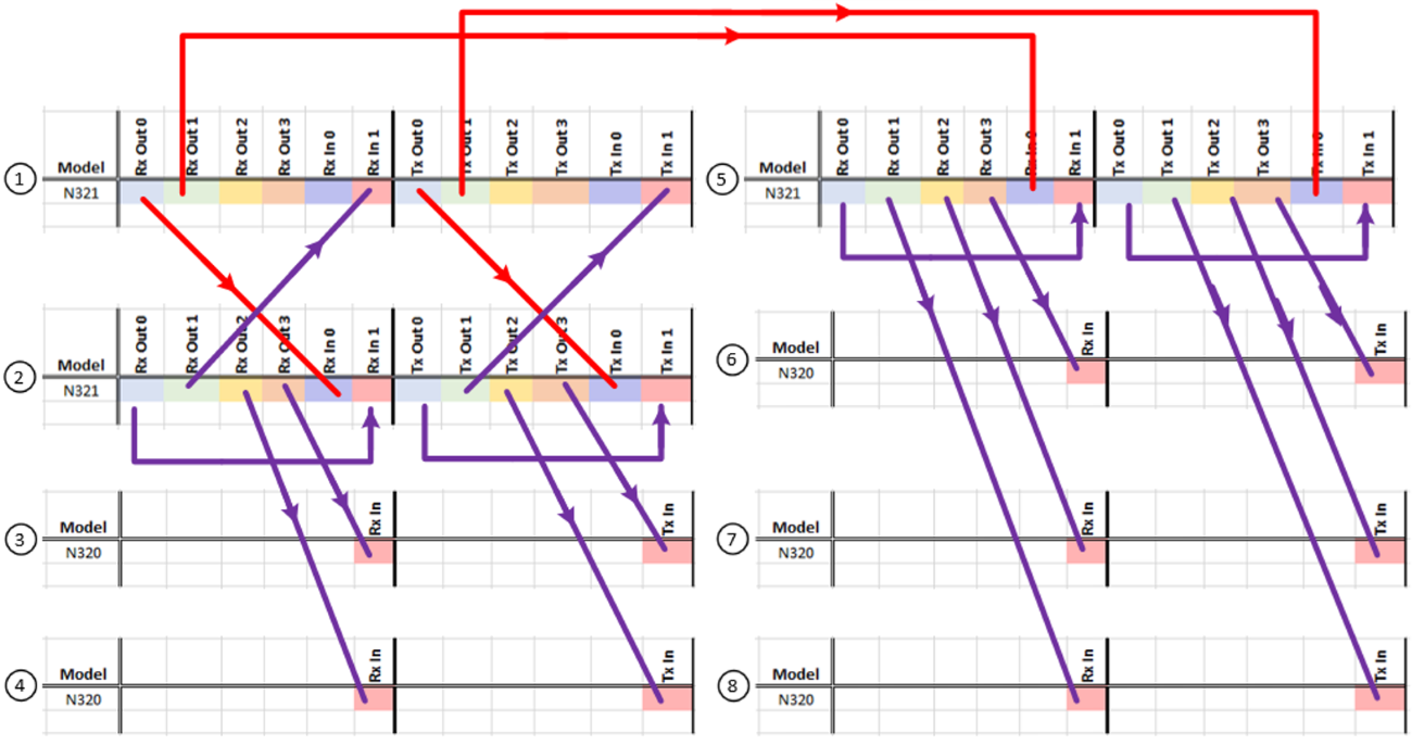

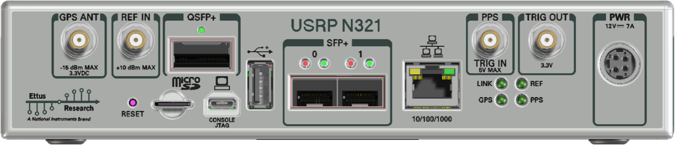

The difference between the N320 and the N321 is in its LO sharing capability. The N320 has a single input for the TX and RX LOs, respectively. The N321 also has the ability to export its LO up to four times, making it possible to share LOs between a large number of N321 devices without having to provide an external, separate LO source. Due to number of connectors required to provide the large number of LO outputs, the N321 does not have a front-panel GPIO connector.

Like the USRP X300 series, the N310 has connectors on both the front and back panel. The back panel holds the power connector, all network connections, USB connections for serial console (see Serial connection), JTAG, peripherals, SMA connectors for GPS antenna input, 10 MHz clock reference, PPS time reference input and output (TRIG in/out), the slot for the SD card (see also The SD card), and indicator LEDs.
The following indicator LEDs are used:
The front panel is used for all RF connections (including the external LO inputs, see External LOs) and all TX/RX connections, as well as the front-panel GPIO.
The connectors labeled RF0 and RF1 are also referred to as slot A, and the connectors labeled RF2 and RF3 are also referred as slot B (matching the internal connections to the daughterboard. Every slot is powered by a single AD9371 RFIC).

Like the USRP X300 series, the N320/N321 has connectors on both the front and back panel. The back panel holds the power connector, all network connections, USB connections for serial console (see Serial connection), JTAG, peripherals, SMA connectors for GPS antenna input, 10 MHz clock reference, PPS time reference input and output (TRIG in/out), the slot for the SD card (see also The SD card), and indicator LEDs.
The rear panel is identical between the N320 and the N321 with the exception of the product name above the SFP+ connectors.
The front panel is used for all RF connections (including the external LO inputs, see External LOs) and all TX/RX connections, as well as the front-panel GPIO (N320 only!).
The connectors labeled RF0 are also referred to as slot A, and the connectors labeled RF1 are also referred as slot B (matching the internal connections to the daughterboard).

The N321 has an additional board to perform LO signal splitting and distribution. The 4 output ports, OUT0 through OUT3, are driven by a 1:4 splitter which can be sourced from the corresponding IN0 front panel port or the LO on the daughterboard in slot A. To use the IN0 front panel port, set LO export enabled to false. To use the LO located on the daughterboard in slot A, set LO export enabled to true.
Each of the 4 output ports, OUT0 through OUT3, have an internal terminator which must be disabled before use. These can be controlled through the RFNoC radio block's API, the property tree, or directly through commands in the MPM shell.
By using matched length cabling with N321s, up to 16 modules can use both of their RX and TX channels while sharing a single N321's LO signal, resulting in a 32 by 32 channel single shared LO configuration. This 32 by 32 channel configuration can also utilize an external LO signal, allowing an already split external LO signal to support larger configurations of 64 by 64 channels, 128 by 128 channels, and larger.
The following diagram shows the connections necessary to create a 16 by 16 channel configuration with a single shared LO source.
