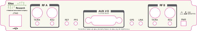

Assembling the X300/X310 kit
Before you can start using your USRP, you might have to assemble the hardware, if this has not yet happened. Make sure you are grounded (e.g. by touching a radiator) in order not to damage sensitive electronics through static discharge!
  1. Unscrew the top of your X300/X310 (there are 2 screws which can be easily loosened using a small Phillips screwdriver).
  2. Insert the daughterboards by inserting them into the slots and optionally screwing them onto the motherboard.
  3. Connect the RF connectors on the daughterboards to the front panel. In order to avoid confusion, make sure the internal connections match the labels on the front panel (i.e. TX/RX is connected to TX/RX).
  4. If you have purchased an internal GPSDO, follow the instructions on Internal GPSDO Application Notes (USRP-X3x0 Models) to insert the GPSDO. Note that you will need an external GPS antenna connected to the rear GPS ANT connector in order to make use of GPS, although your USRP will still be usable without.
  5. Connect the 1 GigE SFP+ transceiver into the Ethernet port 0 and connect the X300/X310 with your computer.
  6. Connect the power supply and switch on the USRP.

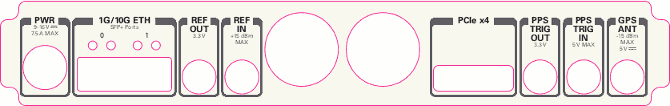

Gigabit Ethernet (1 GigE)
  • Prior to installing the module, the host PC can remain powered on.
  • Plug a 1 Gigabit SFP Transceiver into Ethernet Port 0 on the USRP X300/X310 device.
  • Use the Ethernet cable to connect the SFP+ transceiver on the device to the host computer. For maximum throughput, Ettus Research recommends that you connect each device to its own dedicated Gigabit Ethernet interface on the host computer.
  • Connect the AC/DC power supply to the device and plug the supply into a wall outlet.
  • The OS will automatically recognize the device (e.g. when running uhd_find_devices).
Ten Gigabit Ethernet (10 GigE)
Installing the Host Ethernet Interface
Ettus Research recommends the Intel Ethernet Converged Network Adapter X520-DA2 interface for communication with the USRP X300/X310 device. Installation instructions for this interface are available on the official Intel website.
Installing the USRP X300/X310
  • Use a 10 Gigabit SFP+ cable to connect Ethernet Port 1 on the USRP X300/X310 device to the host computer. For maximum throughput, Ettus Research recommends that you connect the device to its own dedicated Ten Gigabit, Ettus Research recommended Ethernet interface on the host computer.
The LEDs on the front panel can be useful in debugging hardware and software issues (see Front Panel)

Front Panel
X3x0
  • JTAG: USB connector for the on-board USB-JTAG programmer
  • RF A Group
    • TX/RX LED: Indicates that data is streaming on the TX/RX channel on daughterboard A
    • RX2 LED: Indicates that data is streaming on the RX2 channel on daughterboard A
  • REF: Indicates that the external Reference Clock is locked
  • PPS: Indicates a valid PPS signal by pulsing once per second
  • AUX I/O: Front panel GPIO connector.
  • GPS: Indicates that GPS reference is locked
  • LINK: Indicates that the host computer is communicating with the device (Activity)
  • RF B Group
    • TX/RX LED: Indicates that data is streaming on the TX/RX channel on daughterboard B
    • RX2 LED: Indicates that data is streaming on the RX2 channel on daughterboard B
  • PWR: Power switch
Rear Panel
X3x0 Rear Panel
  • PWR: Connector for the USRP-X Series power supply
  • 1G/10G ETH: SFP+ ports for Ethernet interfaces
  • REF OUT: Output port for the exported reference clock
  • REF IN: Reference clock input
  • PCIe x4: Connector for Cabled PCI Express link
  • PPS/TRIG OUT: Output port for the PPS signal
  • PPS/TRIG IN: Input port for the PPS signal
  • GPS: Connection for the GPS antenna
