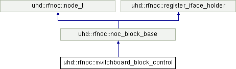

Switchboard Block Control Class
The Switchboard Block is an RFNoC block that routes any single input to any single output. Routing is 1 to 1, that is, an input port can only be connected to one output port, and vice versa.
INIT: This block is initialized with only input port 0 connected to output port 0.
NOTE: This block is not intended to switch during the transmission of packets. Data on disconnected inputs will stall.
