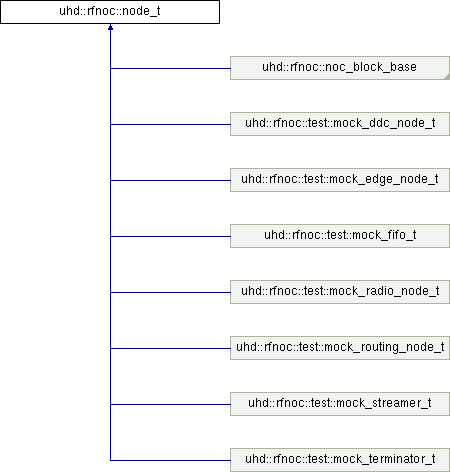

The base class for all nodes within an RFNoC graph
