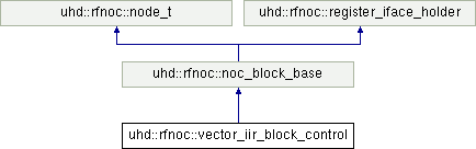

Vector IIR Block Control Class
The Vector IIR Block is an RFNoC block that implements an infinite impulse filter with a variable length delay line. The transfer function is defined as follows:
