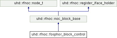

Inheritance diagram for uhd::rfnoc::fosphor_block_control:
