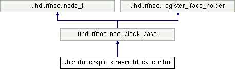

Inheritance diagram for uhd::rfnoc::split_stream_block_control:
