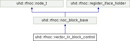

Inheritance diagram for uhd::rfnoc::vector_iir_block_control:
