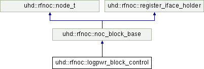

#include <uhd/rfnoc/logpwr_block_control.hpp>
Log Power Block Control Class
The Log Power Block is an RFNoC block that takes in a packet of signed 16-bit complex samples and computes an estimate of 1024 * log2(i^2 + q^2), putting the result in the upper 16 bits of each 32-bit output sample.
