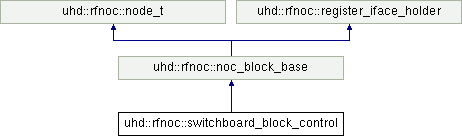

Switchboard Block Control Class
The Switchboard Block is an RFNoC block that routes any single input to any single output. Routing is 1 to 1, that is, an input port can only be connected to one output port, and vice versa.
INIT: This block is initialized with only input port 0 connected to output port 0.
NOTE: This block is not intended to switch during the transmission of packets. Data on disconnected inputs will stall.
Connects an input to an output
Bridges an input to an output. Any existing connections on either the input or output will be dropped.
| input | Index of the input port. |
| output | Index of the output port. |
