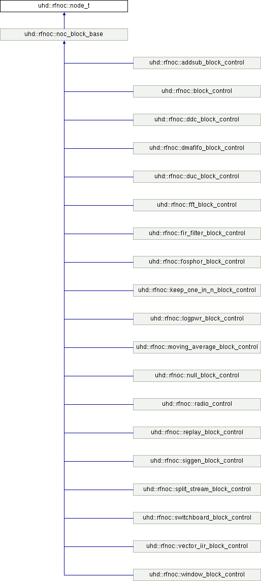

Inheritance diagram for uhd::rfnoc::node_t:
uhd::rfnoc::noc_block_base uhd::rfnoc::addsub_block_control uhd::rfnoc::block_control uhd::rfnoc::ddc_block_control uhd::rfnoc::dmafifo_block_control uhd::rfnoc::duc_block_control uhd::rfnoc::fft_block_control uhd::rfnoc::fir_filter_block_control uhd::rfnoc::fosphor_block_control uhd::rfnoc::keep_one_in_n_block_control uhd::rfnoc::logpwr_block_control uhd::rfnoc::moving_average_block_control uhd::rfnoc::null_block_control uhd::rfnoc::radio_control uhd::rfnoc::replay_block_control uhd::rfnoc::siggen_block_control uhd::rfnoc::split_stream_block_control uhd::rfnoc::switchboard_block_control uhd::rfnoc::vector_iir_block_control uhd::rfnoc::window_block_control
